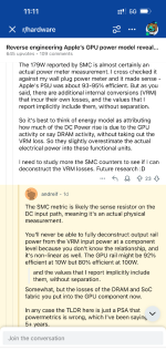

Here is a screenshot from the conclusion:
Essentially, the video posits the idea that Apple’s power measurement tools and apis are incomplete and based on a model rather than measurements. The author noticed a discrepancy between wall power measurement and software measurement. It amounted to a significant power difference. After some analysis, they say that Apple’s model doesn’t account for data movement when stating GPU power. It seems that data movement is increasingly expensive with modern GPUs.
My uneducated question is: does that make sense as a critique of the power measurement that Apple provides? That is to say, I wonder if part of the problem is that in a UMA like Apple Silicon, delineating what constitutes "gpu" power or "cpu" power is a judgement. Certainly the cost of moving data is important in terms of overall power consumption, but isn't it just as likely that Apple judges gpu power as only the alu/computation that takes place within the gpu itself? If so, while Apple should do a better job of accounting for residual power, is it clearly part of a GPU power measurement?

In the end, any benchmark (power or performance) only tells you about that metric with respect to doing “a thing.” The “thing” is arbitrary, but is only of value if it coincides with the thing the consumer of the benchmark wants to do.
Since there is no consensus about what should be measured, the really important thing is that Apple be consistent across generations, etc., so that a user who has product X and is considering purchasing product Y can make a decision.
On the engineering side, everything is modeled. If I’m comparing one multiplier to another, I extract the values of all the parasitic capacitances, plug that into a formula with the frequency and voltage, and produce a worst-case number that i use for comparison. Perhaps I get fancy and, for blocks where wires may switch with different frequencies (i.e. some switch every cycle, some don’t, etc.) I take all that into account. I use this for all sorts of things, like comparing two possible designs, figuring out if there are transistors that I can shrink to reduce power and yet meet timing requirements, etc. I tend to do this at the block and sub block level. This generation’s floating point unit vs. last generations. The multiplier with the floating point unit. Etc.
What I don’t do is gin up some particular cross-block operation and figure out what the power of that particular operation looks like.
On the marketing side, it’s all arbitrary, and the only golden rule is consistency.
