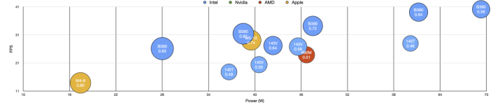

Since I was mostly interested in Mac performance and efficiency figures, I didn't publish anything on the GPU as, until recently, the benchmarks NotebookCheck used, The Witcher 3 and Cyberpunk 2077, weren't native. Now with the native release of CP 2077, I can now start doing GPU analysis! Again, this is Cyberpunk 2077 performance data from NBC with idle power subtracted out (oh and I didn't use any Qualcomm data as CP 2077 is still not native for Windows-on-Arm):
(expand thumbnail to see bigger chart) This is running the benchmark at raster only, no RT, 1080p Ultra. I did include Nvidia data on the larger chart, but as all their devices used more than 70W the area around 40W became too scrunched to see anything, so this is an expanded graph of the lower energy GPUs that are more relevant for this comparison anyway.
Bottom line, the new B390 GPU represents an improvement over the Lunar Lake and Arrow Lake iGPUs as well as Strix Point's 890M and is even slightly better than the M5. Of course, the B390 is a bigger GPU than all the rest*. One of the big improvements Intel made was to increase the core count from 10 to 12 cores and over 1500 compute units. This alone helps improve performance and efficiency as typically power goes up linearly with core count but exponentially with frequency. The M5 meanwhile has 10 cores and over 1200 compute units but has double throughput on FP16 tasks when relevant.

For the GPU, things tilt a little more in favor of Intel’s B390 where the greater number of cores helps the Intel GPU with performance and efficiency. Also, the CPU can still matter in 1080p gaming and graphics benchmarks and so one does have to caveat that the Intel graphics is doing quite well here given that the Mac's CPU is much more efficient than its Intel counterpart. While CP2077 is a better showcase for Intel than some of the others, it’s by no means Intel’s most favorable benchmark, clearly TW Pharaoh, and the performance ratio relative to the M5 in CP2077 corresponds well to the expectation set by Steel Nomad:
