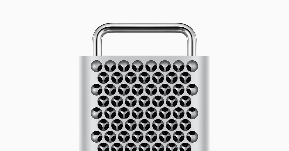

The Mac Pro seems a little pricey but I think it also portends a new understanding of what the Pro is - it is not so much performance (since Studio has the same SOC) but expandability with special PCI cards.
Totally agree overall. And many people need PCIe expandability and cannot (or don't want to) use expander chassis.
Unfortunately you’re not getting true expandability :( - if I’m counting correctly there are only 16 actual lanes of PCIe, maybe 24 but I don’t think so.All the slots are on switchers so as you saturate the routes you’ll lose performance quickly

Tech specs are up but they don’t mention it anywhere:
They only mention slot size, not how many true lanes there are. This is the best you’re going to get and probably accurate given the source:
As someone else noted Apple is being very careful and cagey in their wording about the PCIe.
